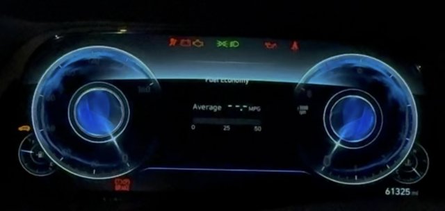

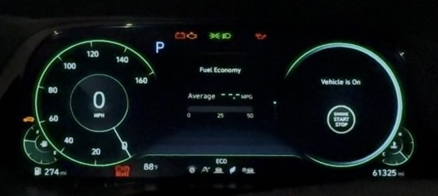

Thank you for posting. At least I know we aren't the only ones!
Mine is a 2021 Palisade Calligraphy, too. Three times it has decided not to start when I have the fob inside the vehicle, foot on brake and push the start button. Nothing happens at all. Last night, it was dark and there were no lights on anywhere. I decided maybe the clamp on the terminal may be loose so I opened the door to go check that and when I opened the door, everything lit up. I managed to get a picture of it rebooting and then telling me that the Vehicle is On. HA!
